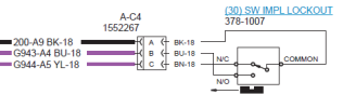

I have just had this happen to my 2017 299D with the Red E695-3 followed by the Yellow 2686-8. I was in the process of securing the rear up on blocks for track removal and did not notice that my front sank. Of course, I had to take the door off to get in lol. I secured the magnet so I could disengage the parking brake (no jumper behind the seat) and my hydros are seemingly locked out. The icon will not go away on the panel. I do not know if my switch is bad or another issue is there. I am only a novice with a multimeter but i did get 1 reading on the switch so "assuming" it is good.
Oh, the codes are there for a short while and then later on are not even logged. Any points to the right direction, on either issue, would be much appreciated.

CAT just called me to say that the jumper is a hydraulic jumper and is required.
29,379
Which jumper are you talking about.?
Part Number 378-1028 to install in the connector on the floor behind the seat for a situation where the door switch/windshield wiper wiring harness has been disconnected.?
I'm fairly sure all you need to do is to disconnect the switch right at the door (illustration below) and then jumper Pin C on the connector to Pin A. If that doesn't work then jumper Pin B to Pin A. (Pin letters will be moulded into the connector)
FYI the way the switch works is that the ECM has to detect a connection to machine frame ground on one wire of the G943/G944 pair and open circuit on the other to confirm that the door is closed.

Thank you for the feedback. My apologies for the late reply. Local CAT gave me one since it was not in the machine but was apparently supposed to be in there. Now I just have to replace the left drive motor speed sensor.

It definitely should be in the machine. Usually it is zip-tied to the machine harness connector on the floor behind the seat. Sometimes they go walkabout…
What Diagnostic Code do you have.? Have you done any troubleshooting.? The problem could just as easily be a wiring issue. Swap the LH & RH sensors over and see if the problem changes sides or stays where it is. You will have to run the machine a hundred yards or so to get any speed sensor code to clear.

Yes. CAT field service said a tech may have forgotten to put the jumper back after correcting issues. Understandable.
I did switch them and the same (different side) code came up. It was constantly alternating between the red Event 695-3 and the yellow 2686-8. I chose to stop running this machine completely because the alerts kept blocking the backup view lol.
I managed to get the new sensor installed last night but chose to finish with the hoses and covers this morning.
