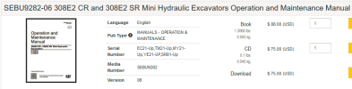

This is what the Operation & Maintenance Manual (should be one in the pocket behind the seat - if it has gone AWOL then you really need to get a replacement) says: -
My first thoughts would be: -
Check alternator output.
Check battery voltage.
The O&M Manual for your Serial Number is Cat Publication reference SEBU9282.
