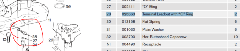

I'm hoping the (slightly) older generations can help identifying this through connector that runs through the compression brake housing. Cat part number would be ideal.
I've searched through SIS, came up empty. Thought it might've been a 6I-1486, but that has a round bullet style connector, this one has spade terminals.
I believe it's off a 2EK 3406B, no full s/n sorry. Customer believes he has pacbrakes, but cannot confirm. That's all I've got.
Oh and this picture...
Any thoughts?

I just threw two of those away today, if it has Pacbrakes it will only say Pacbrake.
The Packbrake model is P36, it covers all B and C models. If Jacobs it will say
Jacobs with a series number on a tag, the series are 346B/C/D. To rebuild a set of
Pacbrakes it will use a Jacobs tune-up kit. The internal parts are the same, Cat is
the outlet for Jacobs rebuild kits and parts. Some dealers carry them also. The
rebuild kit number is 143-6479.
When the patent ran out is when Pacbrake started. Located in Richmond BC and
Bellingham Washington. Separate parts can be had but it's a slow boat. The kit here
costs $296.00 now use to be $150.00 and it doesn't contain allot of parts, the box
is big enough for a large pizza containing a hand full of parts. The kit has the pass
through connectors your looking for.

Thanks TS, good info. That kit fetches just over 500 bucks down here, at least from Cat anyway.
The parts breakdown of that kit lists 2 of the 6I-1486 connectors, that's our round bullet style connector. So it ain't that.
It also lists 2 x 170-6273 TERMINAL-LEADOUT... wish I could find a photo of these. Might be an $18 gamble for the customer.

No doubt about it... has to be the 025663 Jake p/n
Cat converts this to a 170-6273 Terminal-leadout.
Thanks again.

Sure did, but that protector seems to only marry up with the round 6I-1486 connector... from what I could see.

Also found this reference, which when zoomed in is slightly more convincing...
The rebuild kit comes with both type of pass throughs. But you may as well rebuild those engine
brakes, more than likely tired. The Jacobs 346 used both styles of pass throughs, later brakes used
the bullet type connector, early spade type.
