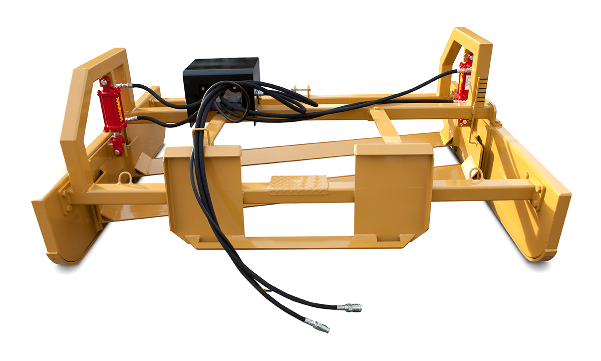

skid steer stype. Here is the unit I'm talking about. Just a box blade looking thing with hydraulics and it comes with a set of wheel on front for floatation.

That's more like a landplane than a box blade. Some landplanes also have scarifier teeth to loosen packed material. Landplanes are much easier to master than box blades but won't carry much material from one location to another. For driveway maintenance I think the implement in your pic. would be a good choice although I'd bet pretty pricey.
