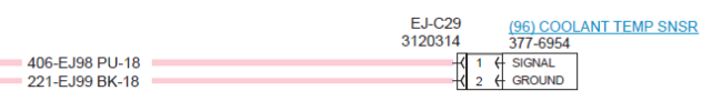

I need a wiring schematic for a 2017 Cat 259D FTL08734. If anyone has one laying around I’d appreciate it!
Matthew26287
Mar 30, 2024
11
WV
The reason I’m looking is I’m having problems with my coolant temp. The advanced display constantly reads 140°. Not sure if anybody has any insight into this? I’ve attached pictures I have 1 active event.

Need to check voltage across those wires with the sensor plugged in somehow. Signal wire voltage should vary between .1 and 4.9 volts or close to it. Start and warm engine. If the voltage doesn't change well that explains what the display is showing (sensor or eng harness issue). If it does change you most likely have a data link or display issue.
For what it's worth try resetting your display as Nige suggested first. Takes 5-10 seconds. Literally press and hold the far left and the far right button on the display for 5 or 10 seconds.

I’ve tried resetting the display with no change. I did check voltage at the plug it said 5v. I’m not sure about checking voltage with the sensor plugged into the actual plug. I’m still curious as to why it doesn’t throw a code when unplugged. There is no changes. Even with a scanner hooked up still reads 140° from engine ECM.
So am I. It should also throw another code when you jumper the two wires. Below .1 volts and above 4.9 volts on the signal wire are supposed to be the trip points.
Spoons are great but I'm not sure you'll be able to get them in there in that location. You might. Just do what you need to do and re-insulate the wires afterwards, not ideal but there's a right way and a wrong way to do it. Spoons will definitely work on the ECM end of those wires (EDIT: no they won't, ECM is Kubota).

I may be able to hook my scanner up and get readings possibly. I’ll have to check to make sure. That’s why I’m kinda worried it’s not throwing codes. I’m thinking it might be something in the Engine ECM.

My money’s on the sensor. But who knows, that’s why we troubleshoot.
I’d prioritise getting voltage readings from the circuit before anything else.

I’m almost certain it’s the right sensor it’s definitely a stretch to reach back too it.
My question stems from the fact that the sensor does not throw a Code whether it is connected or disconnected. You should double-check by confirming the wire colours/numbers (406 Purple & 221 Black) on the machine side of the sensor harness connector.
I double checked. It is the correct wiring in looking at.

Could be the Engine ECM, could be the Display module. Worst case scenario it could be both. Flip a coin, do you feel lucky.?
Well like I said with a scanner hooked up reading from ecm it always says 140° from live feed also so probably leaning more towards ecm.
