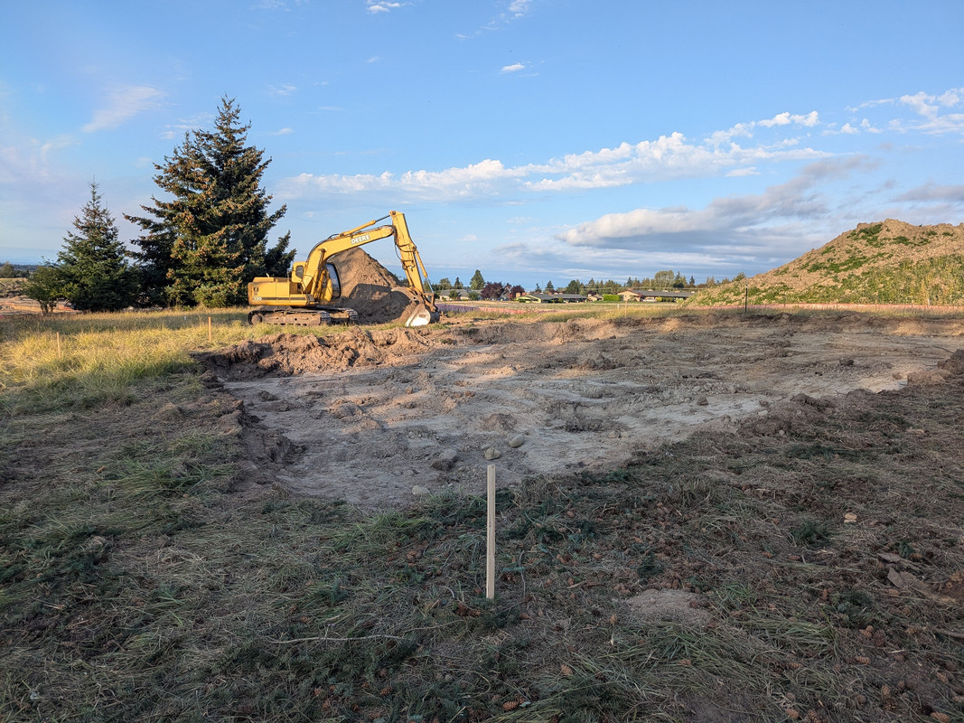

I was able to place all the spoils around my daylight basement dig and then some.
Stripped the topsoil.
Set up a rough grade and then got the magnetic target right.
After the millionth trip out of the seat to check grade, these things pay for themselves when working alone.
Rough dug it to + 2 tenths of a foot or so. This step may vary if you do not plan on a ramp down into the basement dig.
Put on a clean up bucket if you have one and slick it off to grade. Dig footings and plumbing etc.
cooler sized rocks embedded in natural fill is a terrible day(week!) on a small excavator.
Consider hiring the basement dig out to a company with a big machine.
Once those rocks are free of the earth, they are fun with a mini.
