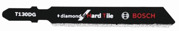

Honestly, if the welding trick cannot be applied due to space, I am dreaming up in my head a type of linear abrasive device. Something I have never seen but maybe should invent I guess...lol Consider how fast a good cutoff wheel might be, but instead of a wheel, have the abrasive on recip saw blade? Do they make such a thing? I realize nothing can really touch the speed of a hot knife, but I'd rather not nick the parent metal.
I'm just in the camp of relieving the bushings to take the fight out of them somehow.

No need to quench, the shrinkage of the weld does the job, provided you lay on a decent size bead of weld. You could run two beads just to make sure. No need for high heat, just normal welding current.
If you're dead set on cutting into it, you could always buy a diamond-coated hacksaw blade! :)

You can get carbide sawzall blades that are pretty effective, but that would be super slow. It's not a crankshaft bearing; just nibble it out with the torch. If you are patient enough to mess with a sawzall you shouldn't have any problem with nicking the housing.
