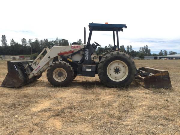

As I didn't know what a Terex was I googled it and found this picture
And this is my MF50
So ** sold the chassis to Terex?
More British mystery stuff.
Joe G
