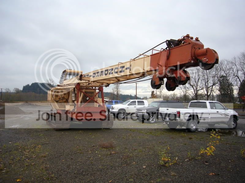

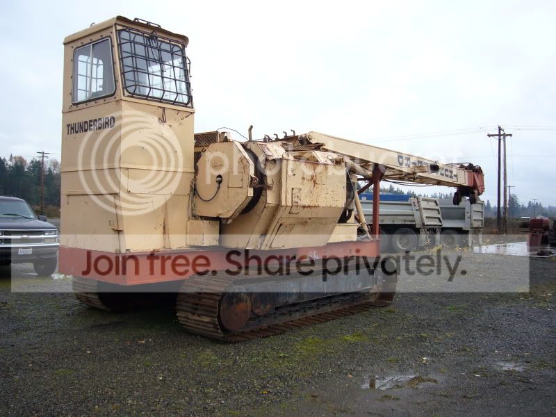

Found some pics of a TMY-45 we had for a bit in the rock pit. Computer file says Nov of 2007. We had purchased it after trying a Skagit 747 and subsequently selling that to Walch after we decided it was bigger than we needed. Never rigged it up, had it all set up ready for lines before we realized our problem. Purchased it sight unseen knowing that the mainline was a split drum, but the A-frame boom resulted in us not being able to run highlead like we wanted. Cascade Trader subsequently financed it to a logger over in Sunnyside. It had the 903 Cummins, probably needed a new injector but otherwise seemed to be a decent machine.
