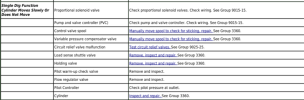

Here is what my manual says to do in this situation:
My problem is that as a newbie, I am unsure how to do these tasks. I completed an online course in diesel mechanics and have spent 40 hours in a hydraulics course so far. I know the principles, but the actual hands on work is not something I have done enough of, but I am trying to get more experience.
I looked up the proportional solenoid valve referenced (group 9015-15), but all it shows there is how to use a wiring test harness that is no longer made or sold anywhere.
For the pump and valve controller step, I don't have the computer. I saw I can interpret the blinking lights, but haven't had the cover off yet. I asked a gentleman from this forum who posted years ago that he had the software to send it, but have not heard back.
I have no idea how to manually move the control valve spool and variable pressure compensator valves to check for sticking or how to repair these. Group 3360 in the manual is just how to disassemble / reassemble these.

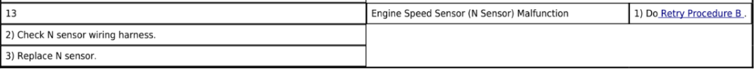

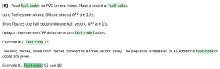

As best my wife and I can tell from this video starting at 1:16 I made, my error codes on the PVC are as follows:
13 - Engine Speed Sensor (N Sensor) Malfunction (Additional info from another part of the manual:
Diagnostic Computer displays fault code ’13’ only when engine speed is not within specification. Nofault code is displayed if open circuit between N sensor or EC
Check engine speed:
P-mode: 2350 rpm
E-mode: approx. 2150 rpm
L-mode: approx. 1500 rpm
I-mode: 900 rpm)

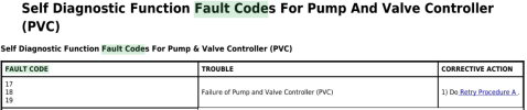

18 - Failure of Pump and Valve Controller (PVC)

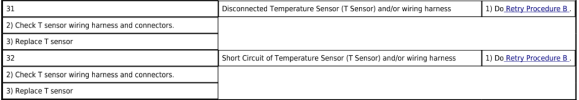

31 - Disconnected Temperature Sensor (T Sensor) and/or wiring harness (Additional info for 31 and 32: The hydraulic oil temperature sensor (T sensor) senses hydraulic oil temperature. If provides the signal for operation of the warm-up circuit. If the T sensor fails, machine operation will be affected by the warm-up function not operating when warm-up switch is pushed.
32 - Short Circuit of Temperature Sensor (T Sensor) and/or wiring harness

We used these instructions from manual 1504:
and here is what the manual says to do for each:
The forum blocks me from adding the last image (only 4 at a time). So here it is copy and pasted:

1. The boom lower function is just weak sometimes, but not slow. I copy and pasted the section out of the 1504 manual above talking about a slow boom, but is that the right troubleshooting area to look at?

Yours would be equivalent to a -2 Hitachi. John Deere has a split at 25000. 24999 and down is -2, 25000 and up is -3.
I would try clearing the codes and running the machine again until the problem appears. Then force it to do the problem a few times so that it will store a code.
