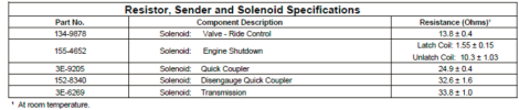

Thank you that is what I was trying find is the codes list and how access them everything I was finding was talking bout a screen and this machine doesn’t have a screen in it all analog gauges and roll style hr meter. The coils/solenoids I’m talking about are on the valve body right side transmission under cab this is what service/ repair manual says for checking them sir. I got set pressure gauges ordered so can check pressures in trans also. I don’t have access to them anymore after changing jobs, I priced through cat don’t have $7000 to drop on a set.
There have been a number of updated Part Numbers for the (6) transmission solenoid valves. The original Part Number for the complete valve was 136-1679 (Coil 213-8760). The quoted Coil resistance at 25 ± 5°C (77 ± 10°F) ... 31 ± 3 Ohms

So it wants it to be 67° minimum to test the coils and get accurate reading? Shop it sitting in is 65° and they all tested 30-33 except 2 tested 20 ordered new ones replaced those 2 now they test 33 also. After replacing them it gets a nice positive shift into reverse actually starts go when remove foot from brake and can feel the shift into second gear those were both solenoids that ohms weren’t correct on according to giant service/ repair manual I have for the machine. It still had the 136-1679 coils in it which when replaced new coils and stems had crossed to a different number and dealer said the coils didn’t cross to working with original stems so had buy the packages deal for them. I’d have double check what the part number was on that. So I guess I’m confused the ohms on the new coils won’t follow what the service/ repair manual says now?
38,694
It happens sometimes. A part gets updated and the specs change. Is there an electrical schematic on your service manual.? What spec does that give.?

It’s the manual was bought with the machine when it was bought new from cat..........I’m thinking we are having a miss communication here sir, I’m saying the numbers your giving me for the factory original coils wasn’t same as book was giving me.
And there may just lie the problem. The machine dates from 1999. If the service manual was purchased at that time then the information it contains will be even earlier than that, maybe by a couple of years. So any changes to specifications, etc, that may have taken place in the online system in the intervening 25+ years will not be reflected in the paper manual. As I mentioned above the current spec shown for the solenoid valve coil resistance for a 136-1679 Valve Assy is listed 31 ± 3 Ohms.
Please cany you take a look at the top RH corner of the cover page of the section of the manual where you found the information about the coild resistance and post it up. I would like to compare it with what the system lists now. I suspect it will be SENR1218-xx but the kicker is what the "xx" is.
