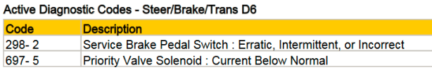

Got a D6R serial prefix 3ZN shifts into neutral sometimes when travelling in forward or reverse. There are 3 active codes, brake pedal sensor, torque convertor output speed sensor and priority valve. Also notice the lights on the dash flash off and on and gauges sweep the same as when your turn the key to on the same time it has the transmission shift into neutral issue. Also seems to happen more frequently on higher rpms. Any help?

These are the codes. I'm thinking it may be something electrical was hoping you could point me in the direction to check

The Brake Pedal switch Code is not Active. It would be RED if it was.
Suggestion: Download a Product Status Report from ET before you go any further. It will serve as a record for how things were when you first connected to the machine. It will also show which Diagnsotic Codes were Active and which ones were Logged.

open the right engine door that is from the seat, then stick your head in and follow the cable up to the plug, you will also need to drop down the dash to see the plug on the bottom right, this involves removing a few more small sections of panel work towards the cab to get at things, pull the plug open and check all the pin connections for green or burnt problems, its a good start with the next point to check involves removing the killer seat to get into the ECM under the left panel, you might also need to pop off the battery box to check out the fuse panel, the brake position switch runs on 24 volts but the transmission works on P.W.M. 5 volts pulsing, the waving of the display is often caused by the plug under the dash, any faulty wires should be pin out tested from the ECM plugs the wires are all numbered, when you get the wiring tamed if the transmission is still playing up I might have a few tips for you to find out what is knackered.

The peddle switch is an easy fix as it is 24 volt, put a bit of board and a soft pad on the track and lean in to the cab, its only a few wires so simple enough, the Priority valve solenoid is best reached from underneath again easy to sort, the valve is below your left foot as you sit in the cab, its around the spider drive shaft area on the back case, you can do a pressure test before and after fitting a new mag valve to confirm your repair, there is adjustable valves on this control that might need some movement but not often the case the wires are if i recall 24 volt to the mag coil.

Nige, I did say in an earlier post to pin out the wires or check for voltage, the plug in the bottom R/Hand behind the dash is well worth pulling open to check for burnt or green connections, it's easy to test the priority mag coil but it's often the spool knackered, the oil pressure gauge with prove this by first reading the pressure at low idle, then cleaning up the mag coil and post and establishing it works (power to it) then seeing if the pressure lifts at low idle, I think it works at speeds below 1350 rpm.

“Ok so we resolved the monitor shorting issue which was neutralizing the machine. It was a bad chassis ground or main switch, by passed the switch and bolted ground to new area.”

Engine was starting fine. I think there was something wrong internally on the main switch and when it picked up a bit of vibration it was giving the issue
