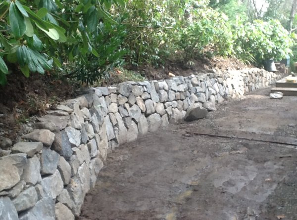

Yeah it’s crazy there is about 4 acres of man size boulders and larger just dumped on the side of the mountain.
I will keep on about progressive thumbs, in light of your rock supply. The only thing that sets rocks better is a clam with swivel. I am not kidding with those rocks and a machine with a clam and swivel, you could do this anywhere you wanted.
with a progressive thumb, it is just a much slower process. With a simple or a fixed thumb, it is relative agony. Do not settle for either of those! You have a priceless store of material on site.
